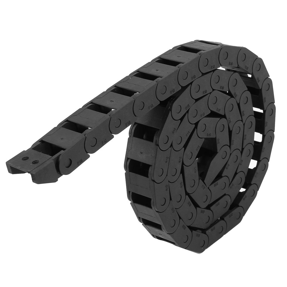

I'd want the other end of the cable to connect at one extremity of the hatch's movement, and have a bit of slack so it isn't tight when the hatch is at the other extremity of it's movement, and rolls along a bit like a tiny version of this.

I wasn't thinking of anything as elaborate as the pic, but I couldn't think of a way to describe the cable run. Basically, and assuming the hatch slides forward to open, the cable - something flexible and flat, rather than round, would be attached to the side of the hatch towards the aft end and facing aft, so it curls down and runs forward, entering the boat somewhere a bit forward of the forward end of the hatch when closed. As you open the hatch, the curl rolls forward, so no stress is placed on the cable. It could just as easily be done the other way round - play with a bit of wire, holding one end down and moving the other end and you'll soon get the idea.
This is what electrical cable support chain like this
https://www.amazon.com/Black-Plastic-Chain-Carrier-Router/dp/B00880AVL2
That is a good idea, and you could run it horizontal instead of upright as in the photo, you would not need a large size as you'll probably use 2.5mm² twin core cable. For going thro' the deck, use the Index Marine Twin deck gland - available in black or white(black is cheaper). https://www.indexmarine.com/product/se7/ Low profile and cables lie parallel to the deck. I've used them on my solar panels.
