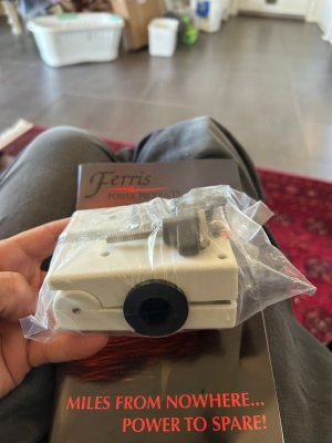

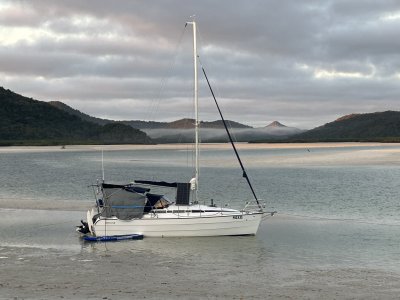

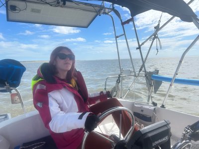

180w panel mounted on my targa bar with two Ferris thumb screw rail clamp style mounts a third of the way down the side of the panel and a rear central adjustable strap. Allows tilting up to 90 degrees rearward and has withstood well over 60knot buffeting. Three more identical 180w panels are mounted over the top of my Bimini with the same Ferris thumb screw style rail clamps but these do not tilt adjust. Another 160w panel mounted using these clamps sits over my cabin mounted from handrail to hand rail and one side is released to allow tilting at anchor. The tilting can make a significant difference as monitored by my phone app to my mppt controllers. IMG_2334.jpeg
