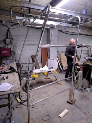

Solent Welding and Fabrication are building our arch at the moment, we went to take a look at the work in progress just before Xmas and it's shaping up beautifully. We'll have about 700w up there along with starlink, GPS and an outboard hoist (no davits for us).
There's a couple examples of their work on YouTube that I've seen: Sailing Polaris and Crazy Ivan.

Have you got any pics? Also can you give me a ball park as to what you're paying? Cheers :)
5-7k is pretty accurate for something solid I'd say, especially if your stern is wide. Our quote was at the low end of this and the final will probably be around the midrange after various changes to the design.
Here's the work in progress when we dropped off the pushpit for integration.
