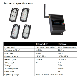

presumably you are talking about a different transmitter/receiver to the one I have, as my receiver definitely (or at least the docs dont mention any battery) does not have its own power source?
Identical to mine..
what type of battery was the one you replaced? maybe a flat disk thingy like in pc units used for running the clock? tbh I don't see what theyd use it for, maybe store settings for the remote buttons combo but that wouldn't make the system work intermittedly, it would fail to run full stop as in various garage remotes.
Sorry for not being clear: Identical to mine as I have no battery in the receiver (base) either - only in the remote (transmitter) as pictured in #26.
The base stores the settings even when not powered, presumably in a non-volatile (EP)ROM of some sort.
