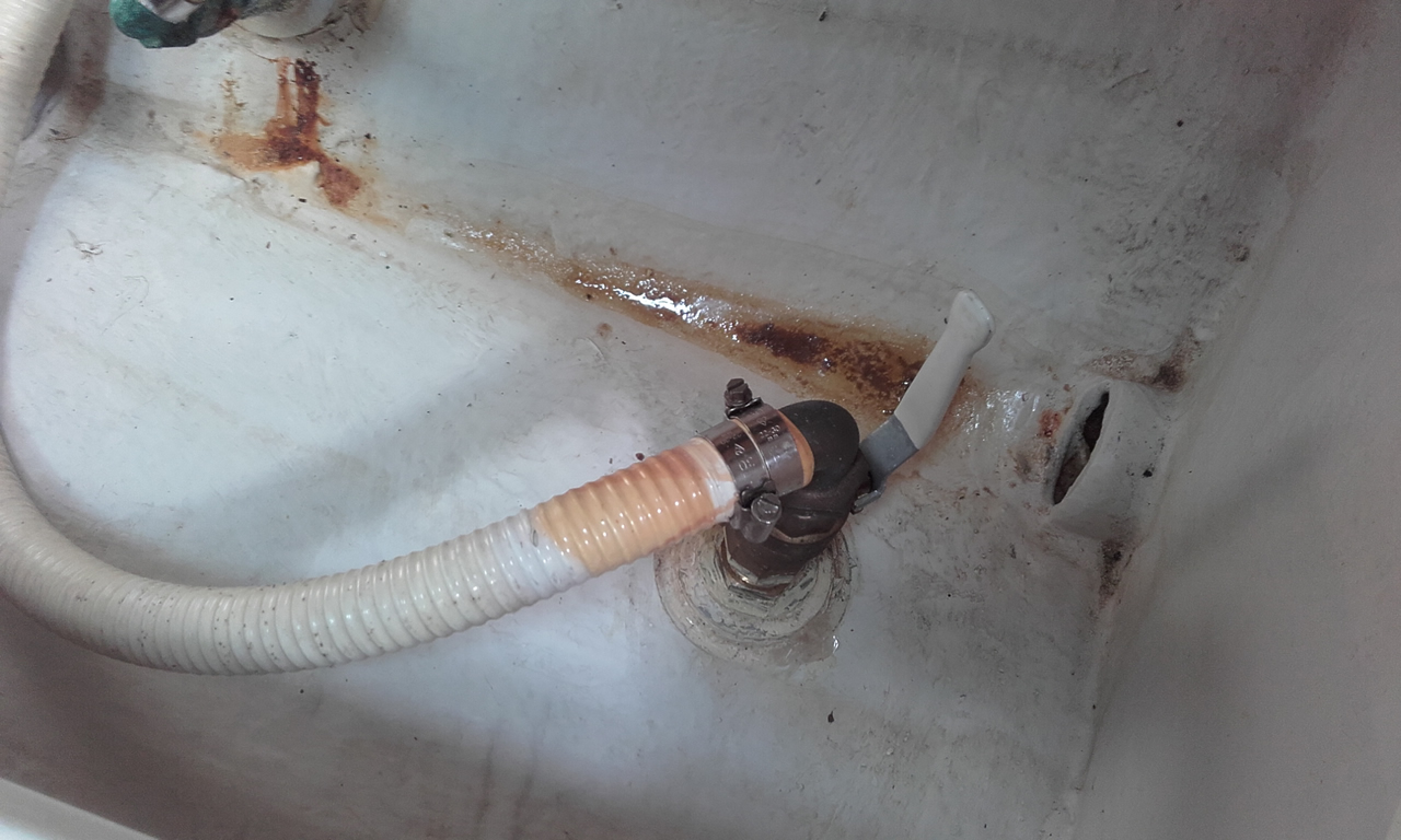

P, out of curiosity, was my guess about the 90deg bend being brass, in this pic which you posted in the "Andiamo" thread?
If yes, it's easy to see why going all bronze wouldn't be a bad idea... :encouragement:
P, I don't know the answer. The verdigris colour of the valve and bend is the same. I don't know if there's any marking on them to indicate what they are made of either.
Incidentally, the seacock with the (external) corrosion is adjacent to another that looks much healthier (no verdigris)...
I wondered if one of the two may have been corroded due to condensation dripping onto it over the years. Since owning the boat, I have cleaned that area of the bilge (including the rust stains) and it's remained totally dry.

re the verdigris on the elbow - give it a really good clean with a Brillo pad and see if it comes up gold. if its pinkish time to get rid.
