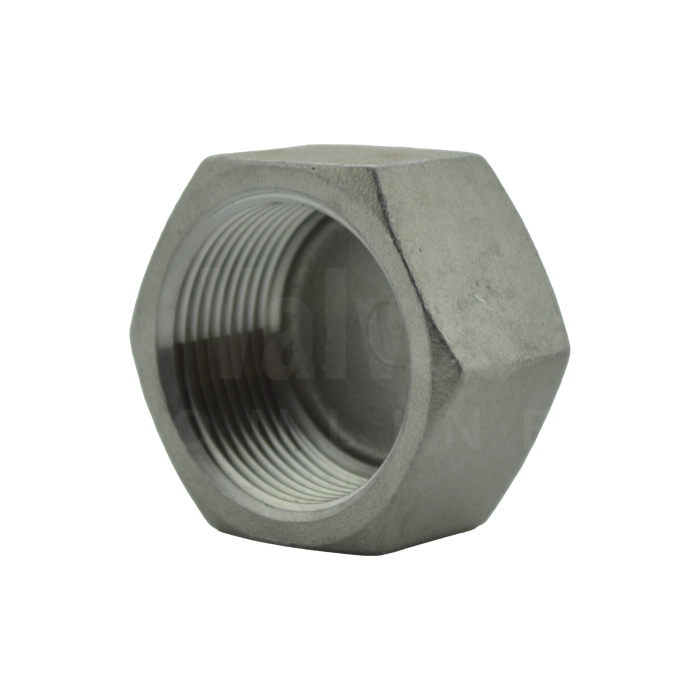

This s what I used to block up some old unused cockpit drain outlet skin fittings
ng
BSP Stainless Steel Female Hex End Cap
