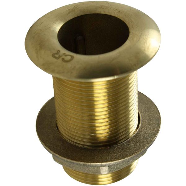

You may well have ageing brass valves and skin fittings but not DZR ones I suggest. DZR valves have been around for a while but not in general use for yachts. DZR skin fittings were introduced quite recently, less than five years I think, similarly hose tails. DZR components are always marked as such, either with the CR mark cast into the body or engraved, as in the photos, or more recently I have seen skin fittings and hose tails marked as DZR.
