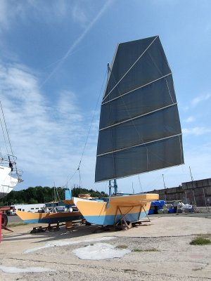

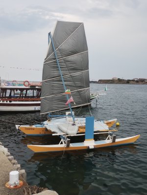

A general picture of the boat, seen from a distance, would be welcome.
I had pain trying to understand how the boat and rigging was made by the glimpses of details.
Anyway interesting. Please keep posting.
Your wish is our command, got lots of footage of a great 200 mile Black Sea cruise, bay hoping and all conditions sailing...
Great boat, very pleased!
Will edit the vid and share it here...

Shunting is changing from one tack to another on a proa. It's not tacking or gybing because neither the bow nor the stern go through the wind. Instead the side of the boat goes through the wind and what was the stern becomes the bow on the new tack, & vice-versa. It's a bit odd, but the Polynesians have made it work for thousands of years.
Arranging nav lights must be fun. You'd have to double up everything & switch them over on each shunt like the double ended ferries do.

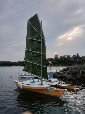

So where's the rudder? Are there two of them?
Most modern Proas have 2 rudders, the front one is in it's raised position while the back one steers the boat.
The traditional ones had a steering oar which would be carried over to the new stern.
Many small Proas will steer and sail rudderless, by only trimming the sail and moving weight for and aft...

Sailing on one tack the luff of he sail exits the A frame downwind of the movable mast, in the present bow direction.
When you shunt, A frame and sail as a whole, turn around the foot of the fixed mast through an angle between 90° and 180°.
If I don’t mistake now the luff of the sail exits the A frame UPWIND of the movable mast, in the present STERN direction and the sail can not be trimmed for the new tack because of the fixed footed mast being in the way.
I can’t understand how before and after the shunt the sail positions can be symmetric (as they surely should be and are).
Where is the bug in my thinking?

In the video below, Jenia films me shunting from the beach, then I show the shunt onboard.
The fixed mast never gets in the way, it's at mid ship and more to windward, it's closer to the 'AmA' (the small canoe). The mast holding the sail is more down wind, more to the side, it's on the Vaka's (big canoe) gunnel, all the way to leeward.
Shunters don't tack, their sail is always above the sea, when running it's 90 degrees to the boat, when sailing to windward you sheet in till it's above the gunnel. when going the other way it's the same, just the sail is on the other side of the boat, when running it's 90 degrees to the boat, when sheeted in again it's over the gunnel. The sail never tacks and comes between the hulls, like a catamaran, it works from the boat to over the sea.
Small hull is always to windward! these craft are the only ones that sail with the same side always to the wind.
