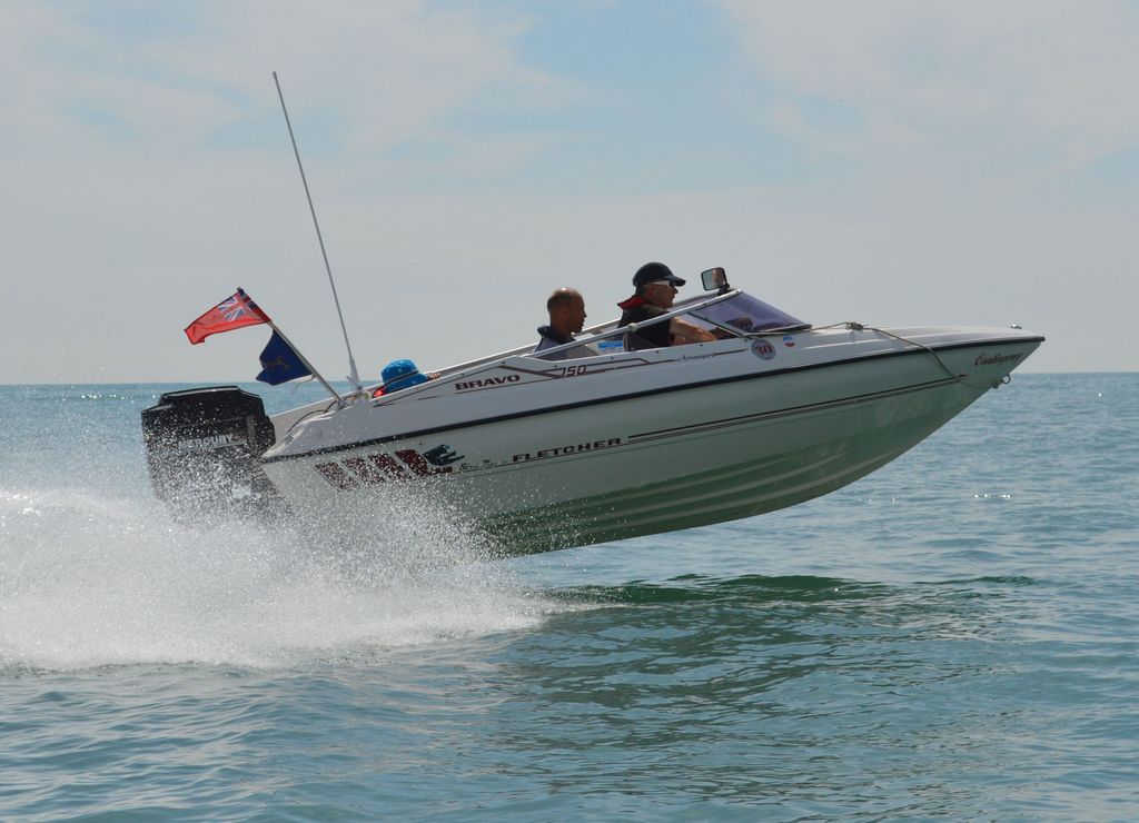

Post 87 has my previous boat, but this is mine since late 2011.
I wonder what I'll be posting to this thread a couple of years from now.........
