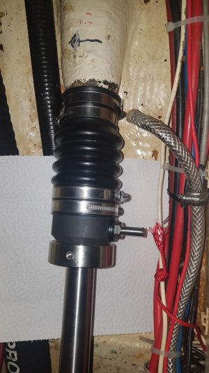

I had a PSS seal on my previous boat for a couple of years, it always leaked a little which I found a bit frustrating.
The leak was eventually fixed by adding a 90 deg elbow to the last piece of water vent pipe - the braided plastic pipe was too stiff meaning the small amount of operating movement of the engine (3ym30) caused the rotor compression to ease enough to allow a dribble of water to weep out.
I eventually had the carbon rotor refaced as you could see the wear was very slightly eccentric - caused it seems by the pipe which was bent at 90 deg to fit the rotor spigot.
Might sound unlikely at first but you can better see how tight the angle was and what I'm trying to describe in the picture:
