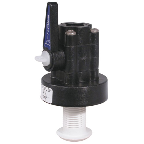

Like this one
Pros, one less joint to leak
Cons cant replace it if it fails without removing the through hull.
I am going to replace all the rather greenish though hulls on my ageing fiberglass yacht soon and was just wondering which to go for.
Thanks
If the originals are merely green clean them up and inspect them. If sound and not showing any signs of dezincification they may be good for many more years of service especially if made of bronze.
the one in your picture looks rather like a speed transducer.
Also look at the TruDesign range. They resemble the familiar skin fitting + ball valve arrangement and I believe can be fitted as direct replacements

I can't see any point in fitting a seacock unless either (a) you have good reason for closing it on a regular basis (my galley sink fills on starboard tack if not shut off) or (b) you have genuine reason to expect the hose to fail.
I can't see any point in fitting a seacock unless either (a) you have good reason for closing it on a regular basis (my galley sink fills on starboard tack if not shut off) or (b) you have genuine reason to expect the hose to fail. Otherwise you are simply adding an additional point of failure, an additional layer of complexity and additional stress on the bit of the whole setup - the skin fitting - which is most likely to fail.
Neither my current boat not my last one had seacocks on the cockpit drains, and I did and do not feel any qualms as a result.
Maybe it's because I only finished refitting the boat a couple of years ago, but I feel like I would miss the ability to remove a hose in order to replace it, re-route it, or get something else past it. For example my engine has a minor oil leak that will need it to be removed, which I may get round to doing this winter, and most likely the cockpit drain and engine cooling hoses will need to be removed from their skin fittings in order to slide it past. I suppose in theory I could whip the hose off and jam in a wooden plug, but I'll be a lot happier (and drier) with a closed valve.

I have replaced my engine inlets with these, and so far very good. I intend to replace every valve in due course. I did add a marine ply backing plate ~ 3 x the hole diameter. The supplied plug allows you to stop the inlet from the outside whilst the valve can be stripped down for servicing. I am not sure I would remove the valve body from the skin fitting afloat - not brave enough for that, besides the skin fitting would likely turn which would break the sealant, for which I used Sika 291.Like this one
