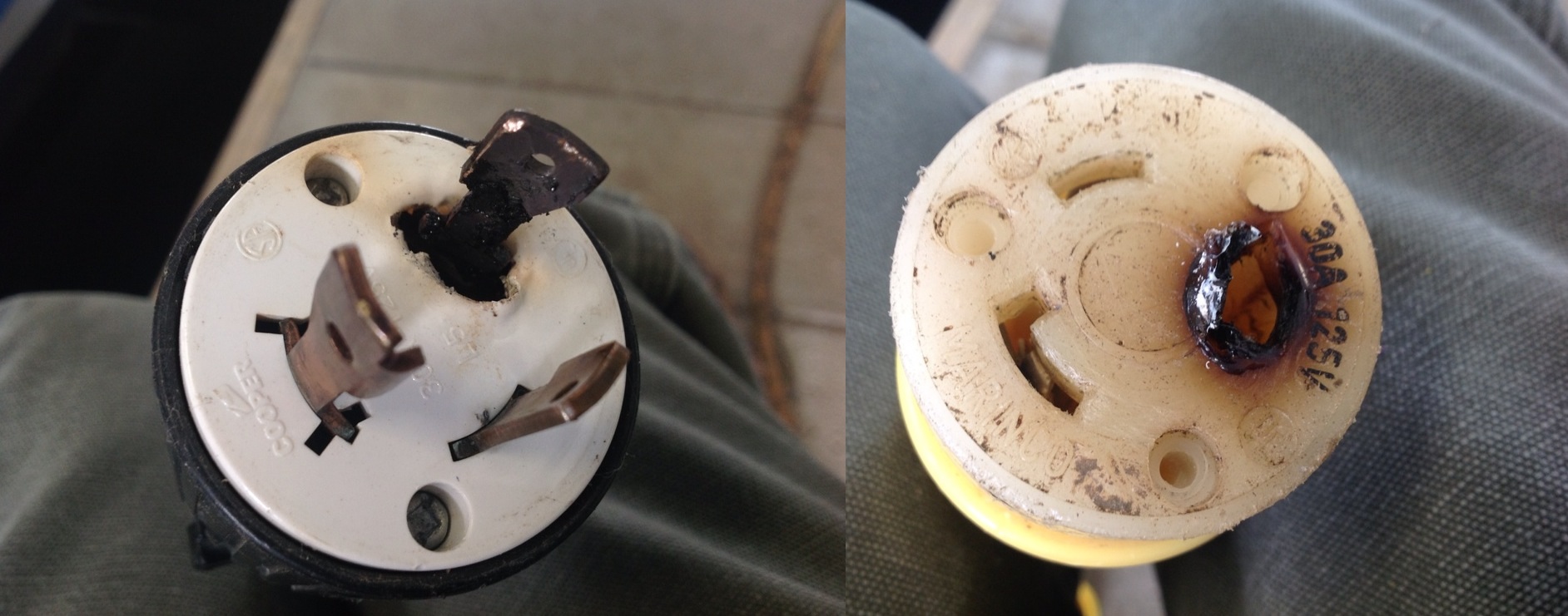

Don't fit the Marinco ones - they tend to have poor contact and the resulting high resistance melts the connector. Happens a lot.
The IEC one (caravan type) is fine, despite lower IP rating. You can get one with a stainless lid from SVB. Mine is on the transom and no problems other than the sealant around it needing renewing after 15 years. There is now also a newer (compatible) version of the IEC one with a waterproof locking collar. Would fit that if I were doing it from scratch. Receptacle link. Plug link. Available from 16A to 63A (where 16A is the sensible choice for most boats of reasonable size).

I changed an Osculatis shore power inlet with the blade type contacts because it was awkward to connect and displayed signs of overheating. The replacement unit is manufactured by Ratio and is secure and positive when the shore power plug is connected, also rated to IP 56. For my shore power cable I use the Ratio female connector on the boat side and a basic caravan style for the shore side and just bought blue outdoor cable. I am pleased with the unit and in 4 years it has not shown any signs of deterioration or water ingress. The lid is very secure and sturdy, as is the whole unit.
Some before and after pictures below. My experience validates Yngmar's comments about the poor contact and overheating. The rest of my 240v system remains unchanged, hence the issue was with the Osculatis socket.

An interesting article. I'll certainly be taking a look at my shorepower plug/socket, but I wonder if this problem is restricted to the NMEA L5-30 standard or whether it is of wider concern?
