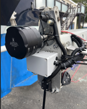

The cable is 0183 and the transducer is a LCJ Capteurs CV7 - I took a picture at the weekend, not very tidy but I'm confident it will be robust.:
I think I will leave the cable as it is, uncut, and just hide the excess in a piece of cable cover. This will not be as tidy, but does mean I will not have to cut the cable at this time.
If I need to remove it at any time in the future, then I can cut the cable and use the above advice to reconnect.
