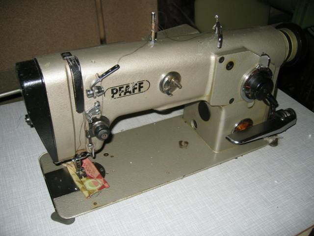

If you want heavy duty and zig-zag keep an eye out for second-hand industrial machines. I have an old PFAFF 437 on which I have repaired sails, converted them to roller furling, made stack-packs, biminis, etc. Although the machine was originally three-phase I altered the same motor to run on single with no problem.
If you can find one, they are usually dirt cheap but are massively heavy.
Similar to this one:
