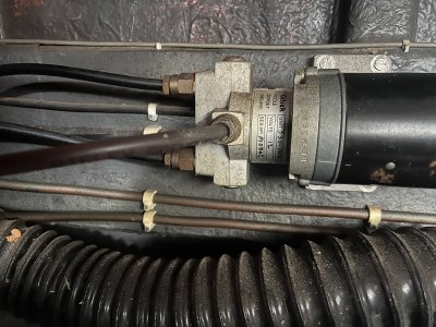

My query is the pump

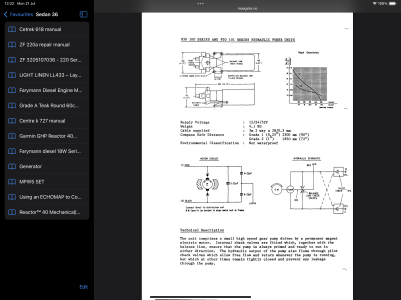

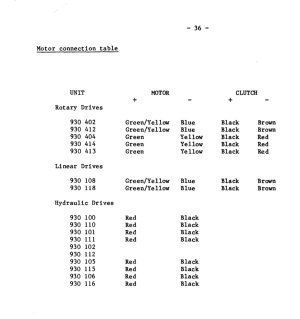

The pump is a 930-100. I’ve attached the manual referencing it and it appears to just be a 2 wire affair….red and black. That makes sense as it will just reverse polarity to run the pump one way or the other. The ghp 12 can cope with that (and can support a clutch too but looks like there isnt one.

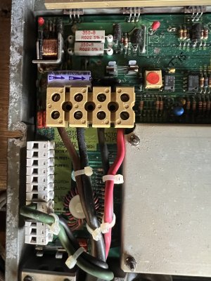

What’s confused me is the existing wiring as attached
Light ship (green and black 12v live according to my volt meter)
Pump supply ( brown and black 12 live again)
Pump output (red and black no voltage)
Am I right that “light ship” is to power the cetrek system and “motor supply” is more heavy duty supply just for the pump. What’s thrown me is the the name of light ship and gauge of the wiring is all pretty much the same

The pump only has 2 wires, no clutch. If the AP is engaged you cannot steer, but some systems will allow you to turn the wheel and change direction to a degree, but the AP will correct the course. You can optionally fit the Garmin shadow drive, which automatically disengages the AP if the wheel is turned, IMO it's very overpriced and not necessary.

Light ship (green and black 12v live according to my volt meter) Remove this wiring, it was to power the Cetrek system, as you thought.
Pump supply ( brown and black 12 live again) Use this for power to the GHP 12
Pump output (red and black no voltage) This goes to the pump
