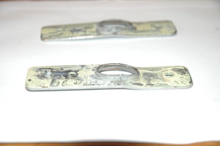

I've had boats with both Z-spars and Selden.
Selden mast are much better quality, and the rigger I use says everthing fits as it should do, and find them quite robust. the down side of Selden, is that they are a nightmare to deal with, they won't talk to the end user directly, you have to go through an approved rigger, and that can be a nightmare in it's own right. Selden spares are also very expensive. I found the best bet is to deal with AllSpars in Plymouth.
Z-spars a down a significant notch on Selden in quality, and I've had problems with the mast track at the goose neck, the metal retaining plate for the plastic slides was held in place by 2 set screws and taped into the aluminum extrusion. Over time the thread cut into then Aluminum, stripped, corrosion (SS set screws in aluminum) and the fact that the aluminum is very thin. when that happens all the slides fall out when lower the main. I found this very difficult to repair.
The second problem was the SS inserts where the "T" bar terminals hook into the mast. these cracked with metal fatigue.DSC_3368-doc.JPG
On the plus side, Z-spars where supper helpful, you could talk to the man dispatching the spares and, they were reasonably priced.
On balance, if the cost isn't prohibited, I'd go with Selden, I think they produce more robust product.
