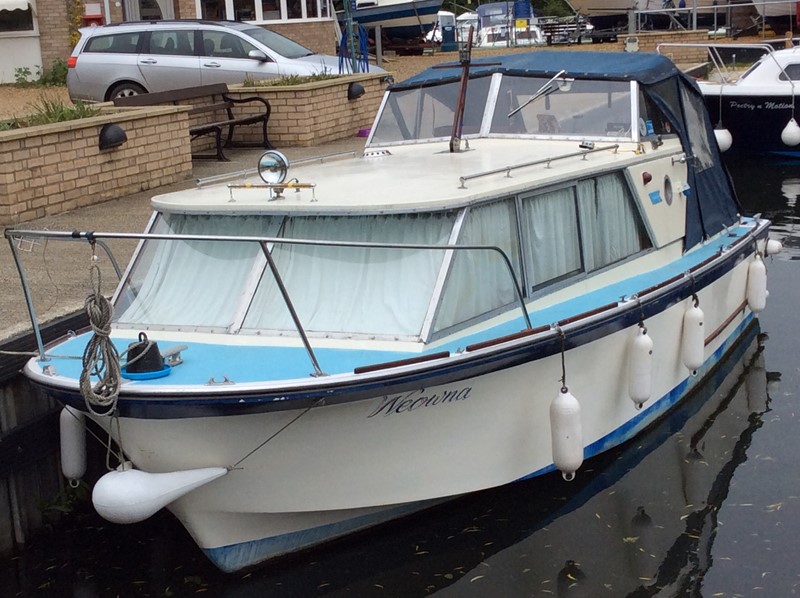

A Seamaster 23
... You can tell its a mobo by the dangly things round the sides
