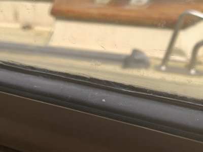

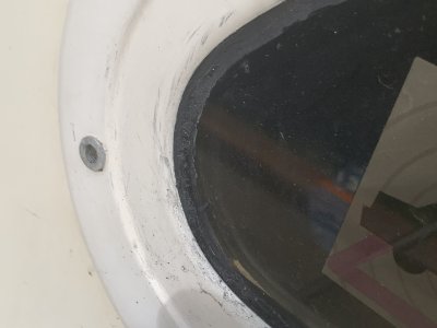

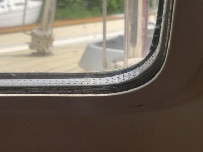

The windows on my deck saloon Seastream have been installed with sealant. Not surprisingly that has slowly degraded and now some leak.
Would I be better to remove them and use butyl tape instead? I recall someone suggested it a while ago and that’s what motorhome use on their windows.

The photos seem to show the sealant that holds the glass in the frame breaking up rather than a problem with the seal between the window frame to the coachroof. This latter joint is the one that might benefit from the use of some form of butyl tape, or indeed the Scapa bedding tape referred to by RunAgroundHard in post 5, but the former joint won't.
If, as it would seem, the problem is with the sealant that holds the glass in the frame, I believe it is possible to trim that back and replace it with a fresh bead of sealant (such as the Arbosil stuff that RunAgroundHard also mentions). I hope so - it's what I'm about to do to the windows on my own boat.
