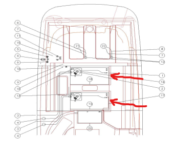

Hi everyone I have a Sealine s34 and I think I have a fuel tank leak or the pipes have come off where can I locate the fuel tanks and how can I replace if needed thank you for your time
Not sure exactly how you would replace - might need some furniture to be removed to wrestle it out.
But the tanks are underneath the beds in the rear cabin.
Thank you so much for the reply and diagram this has help me so much I had a leak in the bedroom in between the 2 beds now it makes sense I couldn’t understand how it got there because there is a hatch there but it’s bilge entrance but it has come through the side of the bed
