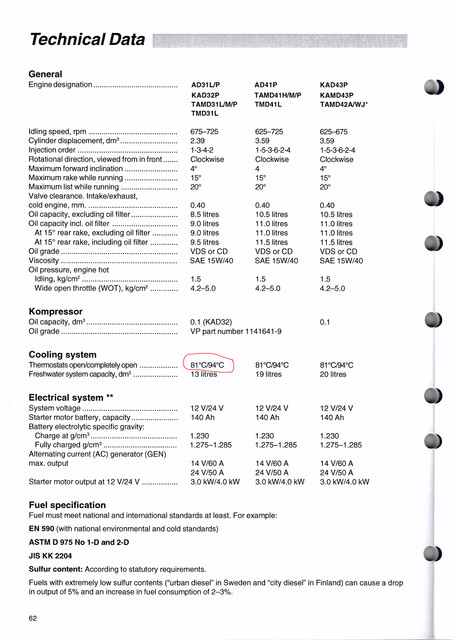

Found the temp specs in the book that came with my KAD32 says 81/94 degrees C so perhaps my temps were ok. See attached
Perhaps the issue was I was comparing them with my Mercruiser 3 ltr which seem much lower but raw water and no pressurisation of course
In my limited experience raw water cooled engines do run cooler, at least, if the block is relatively corrosion free.
