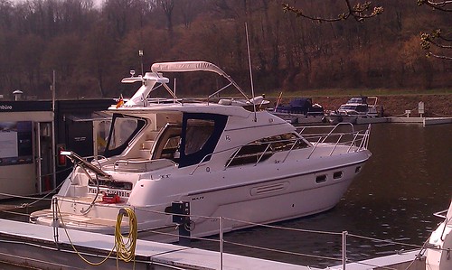

Hi!
Did test my new F43 last weekend, the engines did over rev rather much, I reached 3200 rpms WOT. Fully loaded with diesel and water but no gear and only me onboard.
The Swedish diesel (boat in Germany now) has about 5% less efficiency in it (but more friendly to the environment) which I guess means that I will WOT out at 3040 rpms or so. Still high, or what does the community think?
The engines should do 2800 rpm. Its loaded with a 23" * 29" prop right now, I think the factory one was 23" * 31" prop. Dont know the difference tough.
Reprop or accept the higher WOT?
IMAG0047 by KajLehtinen, on Flickr
/Kaj
I would firstly be testing your tacos with a hand held rev counter as 3200 is way above the no load speed of thoses engines, what speed in knots did the boat achieve? is it both engines or just one? if all is correct it could point to wrong props, what was the speed on the sea trial when you bought the boat.
The tacos can be calibrated with a small pin probe on the back so maybe they have been changed at some point which is certain as the lcd displays fail for the hours, they are universal tacos so do need setting up.
The boat achieved 28.5 knots now, in October when we sea trialed it we got 29.x knots.
At 2900 rpms on the tach I got about 25 knots. Both engines show the same error, also on the fly bridge If I recall correctly. I've asked the dealer to check the revs using a optical rev counter. 2000 rpms gave me about 10 knots yesterday. I got about 3.5 knots at tickover.
The dealer talked about re-pitching the props if they are wrong and asked what RPMs I wanted. Taken account for the 5% loss in Swedish diesel I replied that around 2950 rpms WOT which would make it about 2800 rpms when the boat gets to Sweden (in two weeks I hope!)
/Kaj
