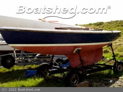

Hello, Love to have some more details so i can update my database on the surviving boats. Mine is Registered number 5, Sunshine. Converted to gaff rig back in the eighties. Is yours the one that was for sale in Essex and had been resprayed at some time ? Blue sails ? Regards. David

Yes .. it is the one from Essex ... I thaught that at the price it was worth a punt ...
I have pressure washed the inside which was rather grotty .. but now I can see what I have got ...

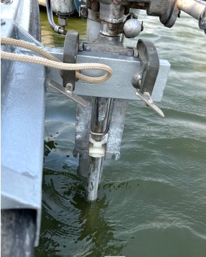

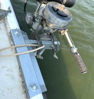

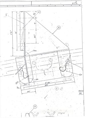

Does anyone have the side mounted outboard motor chair ? I'd love some photos, or to buy it from you, or to get a copy of the rest of the drawing as shown here. Many thanks. David
