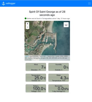

By accessing the data in the Cerbo, I can now see the following info remotely through a web page - most importantly the wind speed and direction I wanted. This is all done realtime though the 4G connection > Cerbo > Signal K > Saillogger.
