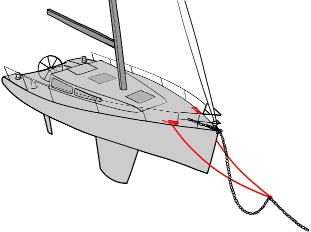

When anchored in a breeze my 9m fractional rigged sloop yacht swings around rather excessively, to a point where it can become beam on to the wind! It is the design of the underwater sections which causes it, spade rudder, fin keel and no forefoot. When there is a tide running it is better and I have a large builders rubble bucket I can use as a drogue to help too. But when there is no tide the drogue idea does not work. Please any other ideas? Has anyone tried tying a warp few metres down the anchor chain and tying onto an aft cleat, then setting the boat at angle to the wind? What angle works OK?
