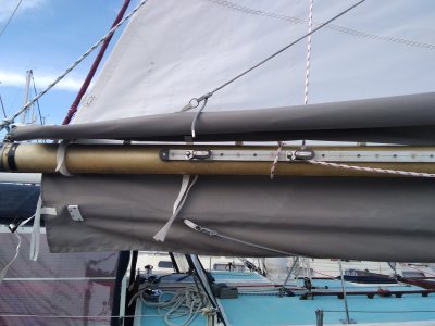

Depends on whether you have a loose footed sail or slugs. Mine is loose footed and the forward part has bolt rope for the first roughly half of the length and then slugs so that the reefing lines can pass through as in the first photo.. If you have internal reefing lines then then you can have a bolt rope the full length. If you have an attached foot then the strip of sailcloth in the groove first followed by the slugs. PITA to get it to fit properly.
Mine was custom made by Kemps with panels of mesh let in the bag for drainage and webbing with rings for attaching the lazy jacks plus extensive reinforcing on wear points. The second photo shows the overall stack pack with mast boot.

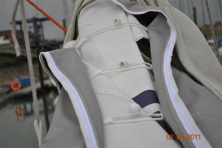

Number of points here.
First: Start the zip at the mast. This means that when you drop the sail you can start zipping up immediately without going aft to catch a swinging boom to engage the zip then going all the way back to the mast again.
Second. Put 4 straps across the sail about 600mm centres from the mast. These should be enough to take the weight off the zip. Also if it is rough one can just do up the straps & forget zipping. When leaving port, undo the zip then one only has to flip the straps. The straps consist of a cord loop one side & a line with a plastic ball the othet. The ball goes through the loop. This can be done with one hand whilst holding on. My sailmaker got these slightly wrong, but it shows the idea.
Third: buy awning channel from a caravan supplier & pop rivet this each side of the boom. The cover can be fitted into these channels & you do not have the hassle of trying to get the sail in the same track as the cover. It is awkward if you have a loose fitted 1/3 foot or full foot on the mainsail. So separate tracks solve the issue
Fourth. Have a separate cover to go round the mast, This reduces the amount of flapping cover when the sail is hoisted

I am confused. You seem to be making things over complicated. Never seen a stack pack with straps across the sail, and never needed any. Ours, like every other one I have seen, can hold the sail in place with the zip undone. Zip generally undone before leaving anchorage/harbour, and not done up until finished sailing for the day - again usually at anchor or in harbour.
And if lazy, sail wet or planning to leave very early next day, can be left unzipped overnight (or longer) - just exposes sail to some more UV and/or rain.
Does you sailcover lack the battens along the top edge?
Also, whilst zipping from mast to stern is probably good on a small boat, the opposite is better with a bigger boat and higher boom - start closure from the stern (which is lower) and slide zip forward - using a long string on the zipper.

To each his own. Just because you have never seen zips starting at the mast does not mean that it is not a better solution for some circumstances.
I only have a 42M2 mainsail. But when I asked the sailmaker he agreed that it was all a good idea. I sail SH & do not want any problems. A stiff laminate sail can be awkward to get into the bag & I do not need one that is excessively large flapping around when sailing. I do have a batten in each section. I do not leave it undone when not requred as I see no point in exposing to UV. That is simply lazy- just my view.
Likewise I undo the zips when leaving port. Pulling zips with bits of string often leads to sticking if the zips get out of line.
Straps just keep everything in place until required. They take the weight off the zip & make zipping easier.
