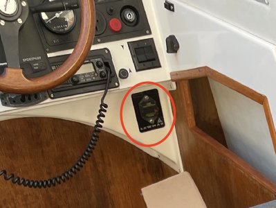

Windlass - we have a separate breaker for this fitted below the steering wheel. It's clearly a retro fit so yours could be anywhere.

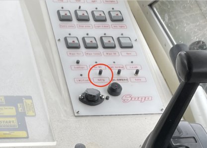

Fridge - we have a push button breaker for this on the 12V panel

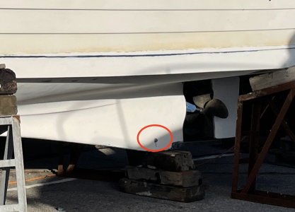

Drain plug - port side of the keel, basically below the lowest part of the bilge. Ive installed 2 bilge pumps in the bilge, one diaphragm pump with a hose down into the deepest part of the bilge and a higher power auto float one in the top of the bilge well in case we take on lots quickly.
Here are the pics of each of these items:Screenshot 2024-08-23 at 23.31.22.jpg

Thanks for the info, appreciate it a bunch! Was able to trace down the solenoid for the windlass and appeared to just be a loose nut. It is working now. As for the refrigerator, I pulled it out and put a meter on the leads and it had voltage. Checked all the connections on the circuit board and they all seemed good. Going to likely replace the refrigerator.
