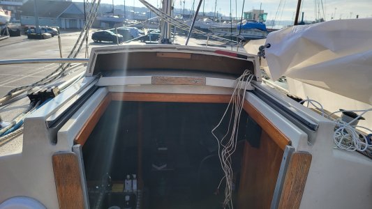

I am upgrading the instrumants on my Sadler 34 and attempting to get cables from the wind, speed and depth transducers to the deck garage along with a backbone.
As the deck is double skinned and cables were installed at the build stage, does anyone know how I can get cables from the chart table to the deck garage without routing them inside the cabin or drilling holes?
Thanks in advance.

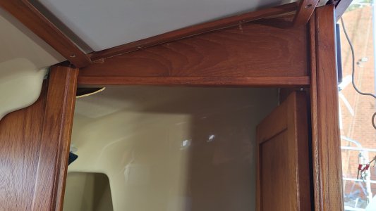

Am I right in thinking you mean this ply over the aft cabin door?
There is nothing under there and if it ran down there, I would come out half way along the window.

Yours must be a later boat than mine. I do not have that piece of plywood, the equivalent infill is attached to the door. However, it seems that I can see the screws in your photo that would allow you to remove it. The wires from the instruments run down beneath it (on my boat). There is a photo showing the piece on my website at Installing warm air heating
I agree it points at the window but that is where the cables run. If you have the ventilator grille, removing that may help also.

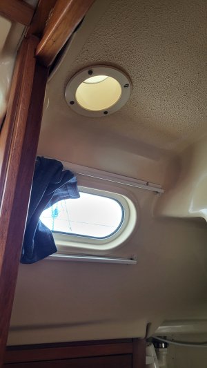

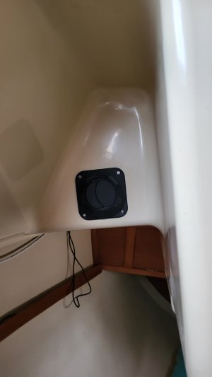

I finally managed to get the cables through after many hours of swearing.
Having removed both the cover from the vent and the vent for the heating in the aft cabin, I managed to get a line from the top vent to the heating vent and then down to the side of the headlining.
The difficult bit was getting the line from the hatch garage to the vent.
The boroscope was a great help as was a stout wire coat hanger and a roll of flat steel, sold at a chandlery as a drain cleaner.
