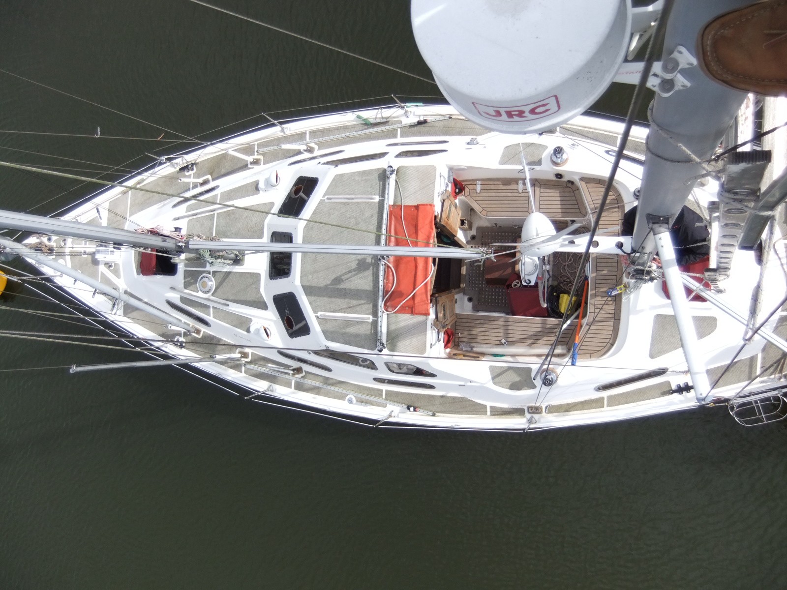

I have a similar boat although a bit narrower (Centurion 32). I use an outdoor paint with very fine sand ("Finetex") bought in a 5-litre pail. Applying two coats to the deck and the coachroof uses less than half a pail so I think that your 4L would be more than enough.
Here is a view from the masthead; perhaps it can help you to compare. That's me in the cockpit.
