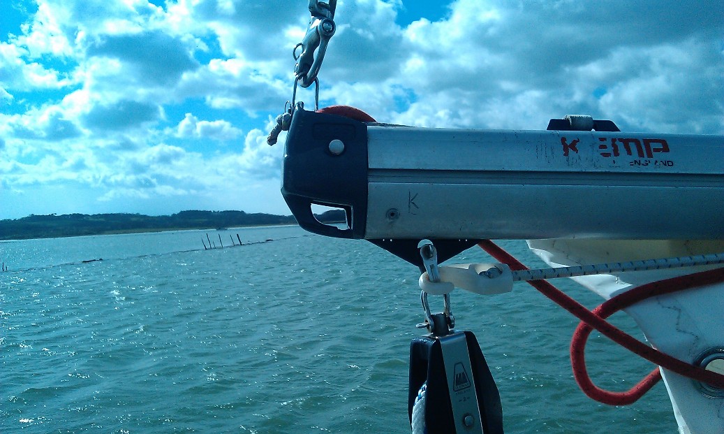

Sorry I forgot last week but I managed to measure mine on Saturday. It is 3055mm from the back of the mast to the pin of the reef line sheaves. The pencil mark in the photo is 3000mm from the back face of the mast. The slider on the top of the boom carries the mainsail clew and at full outhall tension the front of the slider is about level with the back of the letter K of "Kemp"

Arrrgh! Sorry DJE, senior moment confusing you with VicMallows............... That picture is most usefull, thanks again for your time and effort.

When our Sadler 29 was delivered in 1987 the main sheet had been attached to the casting at the end of the boom. It wasn't until a lady sailor who had worked for Kemp pointed this out that we noticed how wrong this was. The photo shows the correct attachment, of course.
DJE's appears to have been also rigged that way at some stage in the past! ..... there has to be some origin for this .......
I have just dug out an original Sadler29 brochure (from 1983/4), showing the prototype yacht "Chrissy" (along incidentally with Chrissy and the girls onboard). The boom is indeed clearly a much more round section that the later production Kemp version; AND the mainsheet is attached to the end-casting, with no underhang bracket. The lead angle of the sheet also suggests the prototype boom was a fair bit longer.
It was attached to the casting with a single shackle when we bought the boat. Hence the wear in the casting. I quickly added the second shackle and attached it to the underside of the boom.
