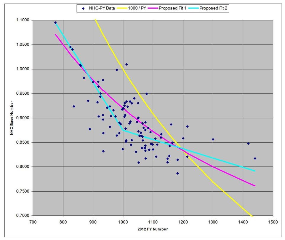

I'm seriously thinking about implementing this for our cruiser fleet this season. The first problem is finding base numbers. Many of our boats are not on the published list but we have PY numbers that we have been using and adjusting for several years so I would like to convert them to NHC numbers. Foolishly thinking that this would be simple I downloaded the current NHC list and the 2012 PY list from the RYA and compared the two. All the boats that appear on both lists are plotted below; the scatter is amazing. The obvious conversion I thought would be NHC = 1000/PY. That is the yellow line and it is a long way from most of the data points. The other lines are my attempts to fit a formula through the points. Anybody else struggling with this?

Looking at it purely as a matter of data analysis, I'd say that the residuals of any line fitted to those data will have too great a scatter for the exercise to be worth doing. Did you compute an R-squared value? If you look at a restricted interval (e.g. between 1000 and 1100 PY), the scatter in the corresponding NHC values is about 0.15 - and the total range of NHC values is only 0.3! So, the errors from any curve-fitting exercise are going to be about 50% of the possible range of values.
In other words, there is effectively no relationship between PY and NHC - which is crazy! But then again, I think racing is crazy :D
Isn't one of the "features" of the NHC that it changes according to race results on a boat by boat basis?
Thanks for the comments. Yes NHC adjusts the handicap numbers after each race to reflect the relative performance of the boats. It saves me from having to decide my own adjustments at the end of each season (and allows me to hide behind the RYA).
My current plan is to use one of the fit lines to get base numbers and then run the adjustments through the last couple of seasons' results to produce starting numbers to use this season.

Try 900/PY for the new base number. That's what our single handed lot in Plymouth are starting with and then using the system properly from there.

Anyway, Mr OP, you cannot expect any correlation between your PY numbers developed after racing at your club with NHC numbers calculated from boat dimensions. For a start, the PY numbers will reflect crew competence so in the case of a regular race boat like a sigma with a decent crew the numbers will be far tougher than they would be for a similar boat raced rarely and with potterers driving it. This is true both club wise and nationally since some boats are common round the country and raced frequently whilst others are rarely raced.
In contrast NHC numbers are derived from a simplified version of the |IRC calculation and are the starting point fopr a performance handical system and not the end point like your PY numbers. Not only that but the system they have chosen is a bit crude and unlike PY does not recognise things like prop choice, twin vs fin keel, spinny or no spinny. Inmstead the NHC system is designed to adjust to actual performance very quickly which is not to say that boats like twin keelers starting off on the first race of a series wont be at a disadvantage to a sigma.
You have two practical ways forward. The first is simply to apply the NHC and let it adjust to performance. It does work or at least we have found it does. The second is to do a bit of simple maths. Select a fleet boat that is well sailed and is a half decent race boat - say something like a sigma 33. Calculate the reciprocal of its PY number and then work out a fiddle factor that will alter thae reciprocal to match the NHC for that boat. Then do the same for all your other PY numbers using the same fiddle factor. In effect you will have created your own list of NHC numbers as they would be after the last series.

For the record the two sets of figures used to prepare the scatter graph were both published by the RYA. They were not figures for our club boats. Granted many of the numbers in the PY list were noted as "very low confidence" and based on very few returns. I have assigned base numbers to all the boats in our fleet (either from the published list or from the PY and the No.2 fit line on the graph) and run the corrections through the last two seasons of elapsed times in our club races - 12 races in all. I propose to use the ratings arrising at the end of this process as the starting NHC numbers for this season. If anybody doesn't like their rating they only have to turn up, do a few races, and watch it change!
