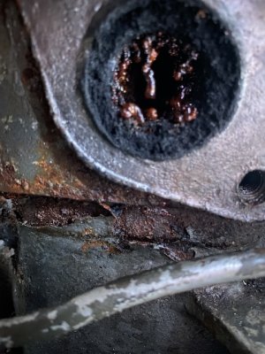

1GM10 exhaust port, as well as being very sooty, seems to have "rusticles"
Going by a photo which I'll try and post in a minute or two. I cant see into it directly.
Access is especially poor because the companionway structure is fixed, so I can only get to the engine from above. I suppose I'll have to unfix it and start coal mining, appropriate for Boness.
The exhast elbow, OTOH, seems in fairly good condition and its annular water jacket doesnt seem to leak into the exhaust. but I suppose water vapour from the exhaust could still condense in the cylinder head, causing rust.
I'm thinking I probably have to take the cylinder head off so I can see what I'm doing. Any special issues with that on these engines (apart from having to buy a head gasket?)

Turn the engine to compression which will ensure the exhaust valve is closed and dig it out in situ. Chisel the big bits out carefully and then spin a small wire brush on a drill in there. Dust sheet pretty essential.
Those 'stalactites' may be a build up of evaporated salt. Pretty sure they will clean out easily.
It was a lot softer, but I have regularly cleaned old tech petroil two stroke exhaust ports that you could not get a 1/4 drill bit through the hole left in the carbon build up!
I did mine recently, exactly as Rotrax suggests. Dig out the big bits (carefully, you don't want to go through the wall of the exhaust port) with a small screwdriver, then a Dremel with a wire brush. Mind you, it would be a lot easier to do it on the bench, so if removing the head doesn't scare you then crack on.

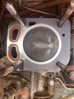

Is this head gasket oriented correctly?
Its unmarked, I find the description on the manual unclear, and its also alleged to be wrong.
I did it smooth side up, mostly because it looked better, but having belatedly looked at thon geezers video above again, that seems to be what he did too, hopefully correctly. My manual doesnt seem to be actually wrong, just a bit unclear.
