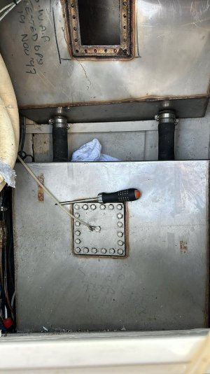

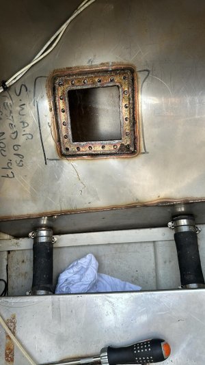

They were very small, maybe 1mm across max. Tank is very awkward..actually 2 tanks connected see picture.

The pictures show the tank I filled and which now will contain a few small rust flakes. I'm not sure if they are steel or aluminium.
If I could drain them enough ( eg at some point in between the tank and the first pre filter ) then I could then open the rectangular hatch (shown in the first picture with the screwdriver next to it) and stick my little electric fuel transfer pump down to the bottom of the tank and suck out a few litres in an attempt to remove most of the flakes which presumably will be there). Alternatively, I could maybe poke some tubing down the filler tube and suck out enough fuel with my fuel transfer pump to then open the rectangular hatch and gain access to the bottom of the tank.
