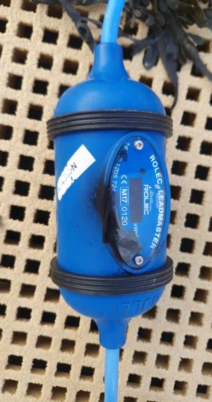

Found this post when I was looking for information when our Rolec meter went out with a bang today.received_344441945119953.jpeg
Went down to our boat and the shore power was off, traced it back and found the fuse was off in the shore power box, so put it back on and the Rolec started making a hissing noise, made a lot of blacks smoke, mini fire and bang.
