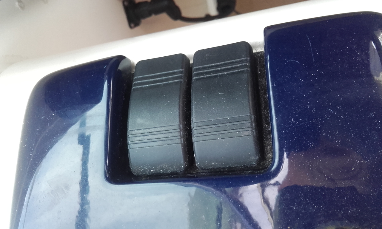

Anyone got a photo of the switches that they use for later / current Targas?
