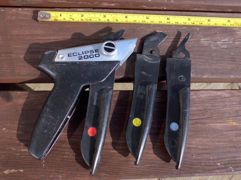

Edit P.S. - the sheets can be cut with sharp scissors.
