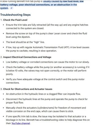

just putting this out there as possible's before stripping a motor/pump down.
Screenshots below from google on bennet trim tab motor - which the simple culprit is fluid level - expanding on that could the hydraulic fluid in your system require changing out if it has never been done ie low viscosity ?
anyhow - here is 2 guides to refilling the system
and here

Thanks Jon. I've no doubt that the fluid that's in there hasn't been changed for 22 years so I'm going to try and extract it and refill to the correct level. Looks like I can get a new cover for £15 so I'll address that at the same time.
