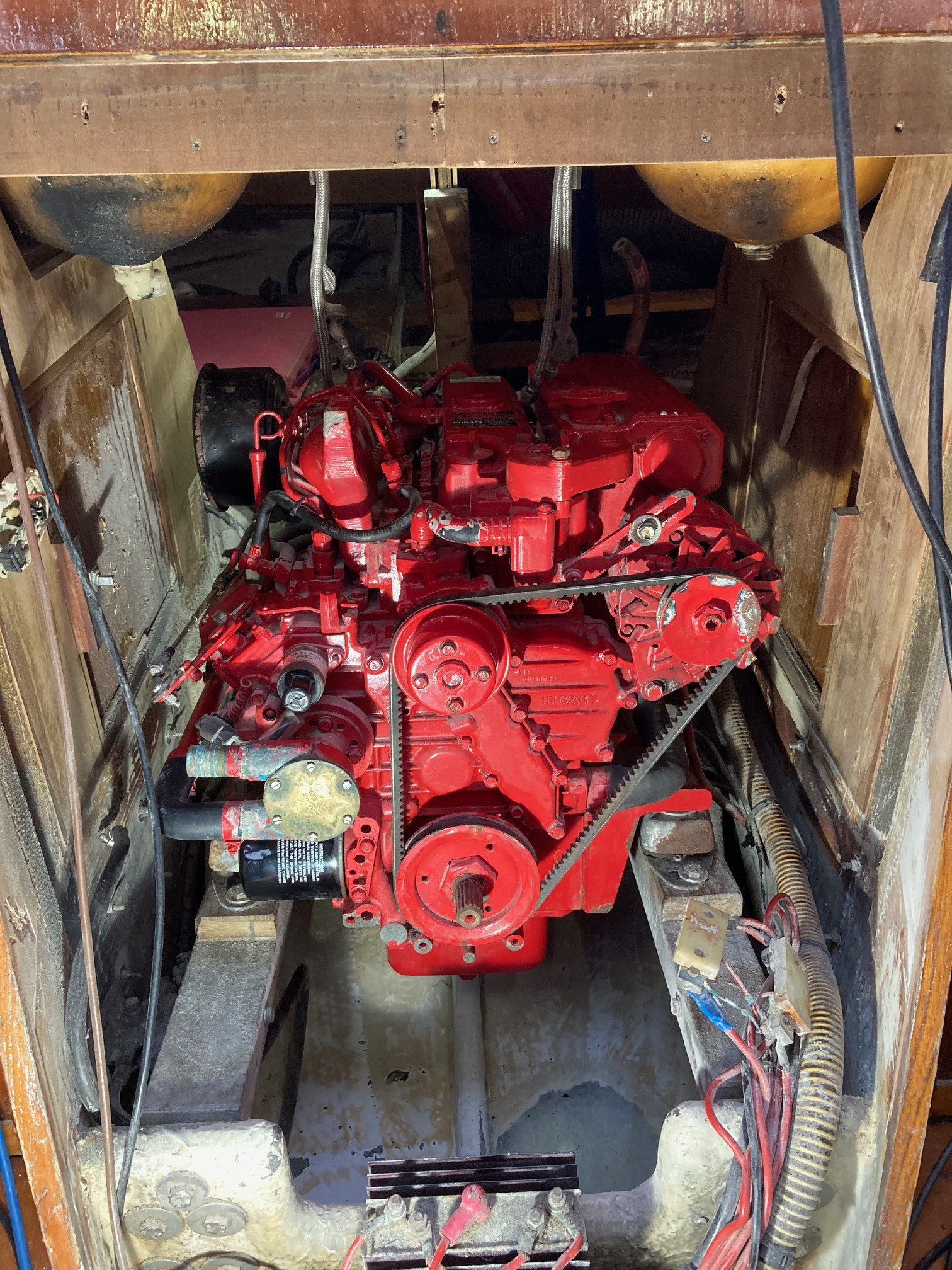

The engine has been de-commissioned for a year or so - much of that time it has been wrapped in plastic and (still!) gathering fibreglass dust. The photos show some of the glasswork in close proximity (new shaft log, relocating through-hulls, even reinforcing the engine bearers, etc.). But that said, I'm rather ashamed of its current appearance in the photos!!!
So assuming the Sun Legende has a similar sized compartment, you can see that overall space is no issue:
It fits nicely on the existing engine bearers. The iroko blocks have been used to raise the engine mounts up about 25mm/30mm. I could feel the old mounting holes are still there underneath - within a few cms at the front.

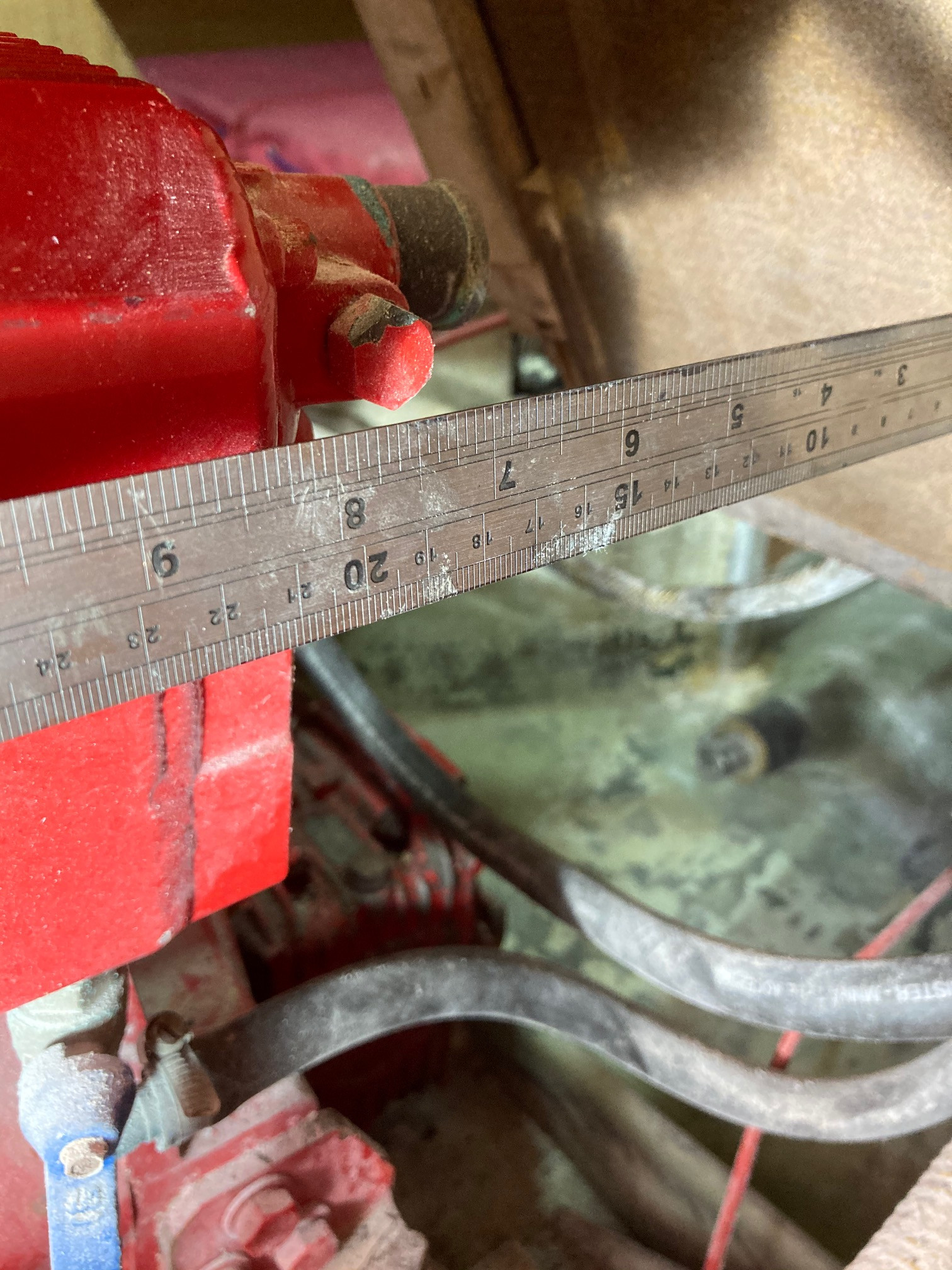

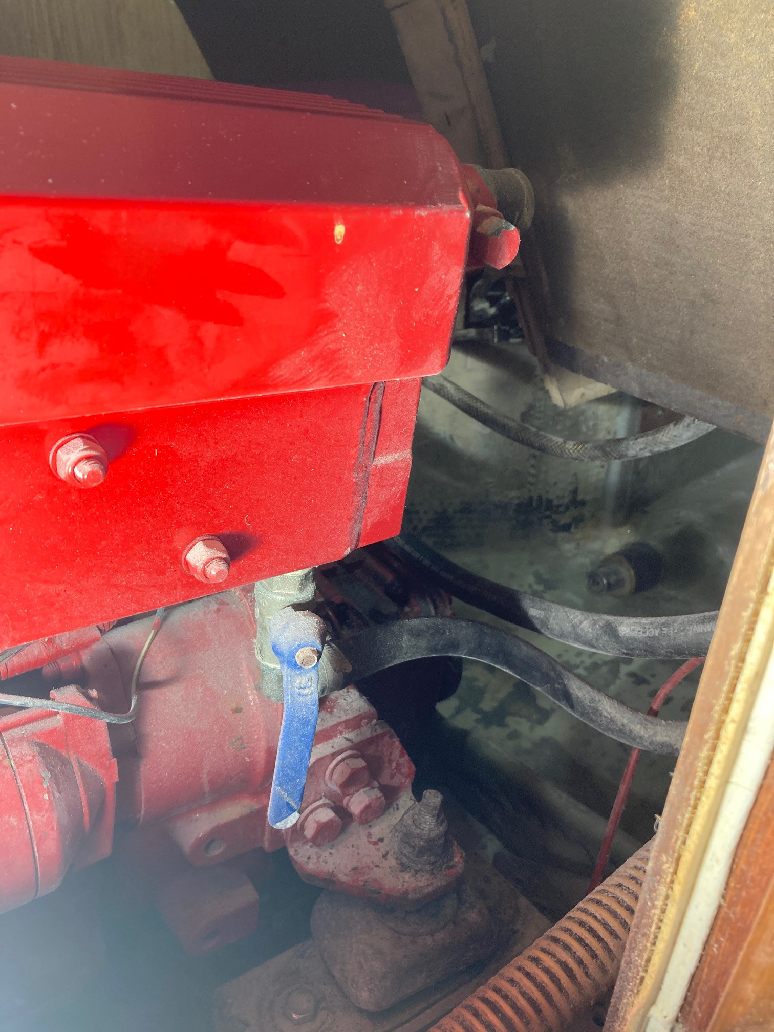

Clearance aft might be a bigger challenge - particular in terms of the exhaust mixer. The standard straight (alloy) Beta mixer fits fine, but doesn't leave the specified height between the water lock as mentioned above. Beta are very helpful, as everyone says on here, and provided me with technical drawings of the crossover mixed via email. With no exhaust/mixer fitted (it should go pretty much where the steel rule is), you can see there isn't much room between the cabinetry. And you need a few cms at least to avoid setting it on fire!

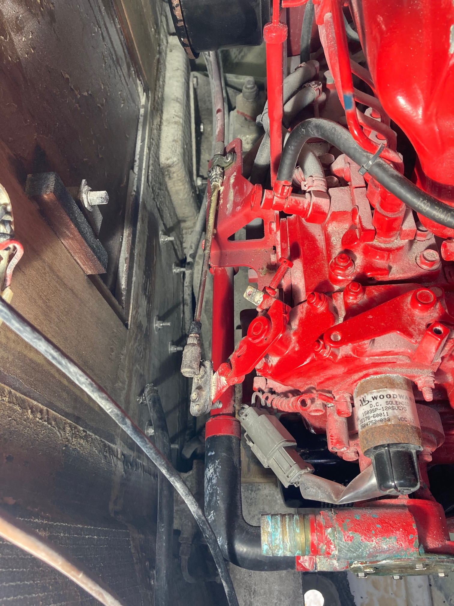

Throttle cable runs to the front/stbd side. Not sure where it is on the M50 as I've never seen one up close:

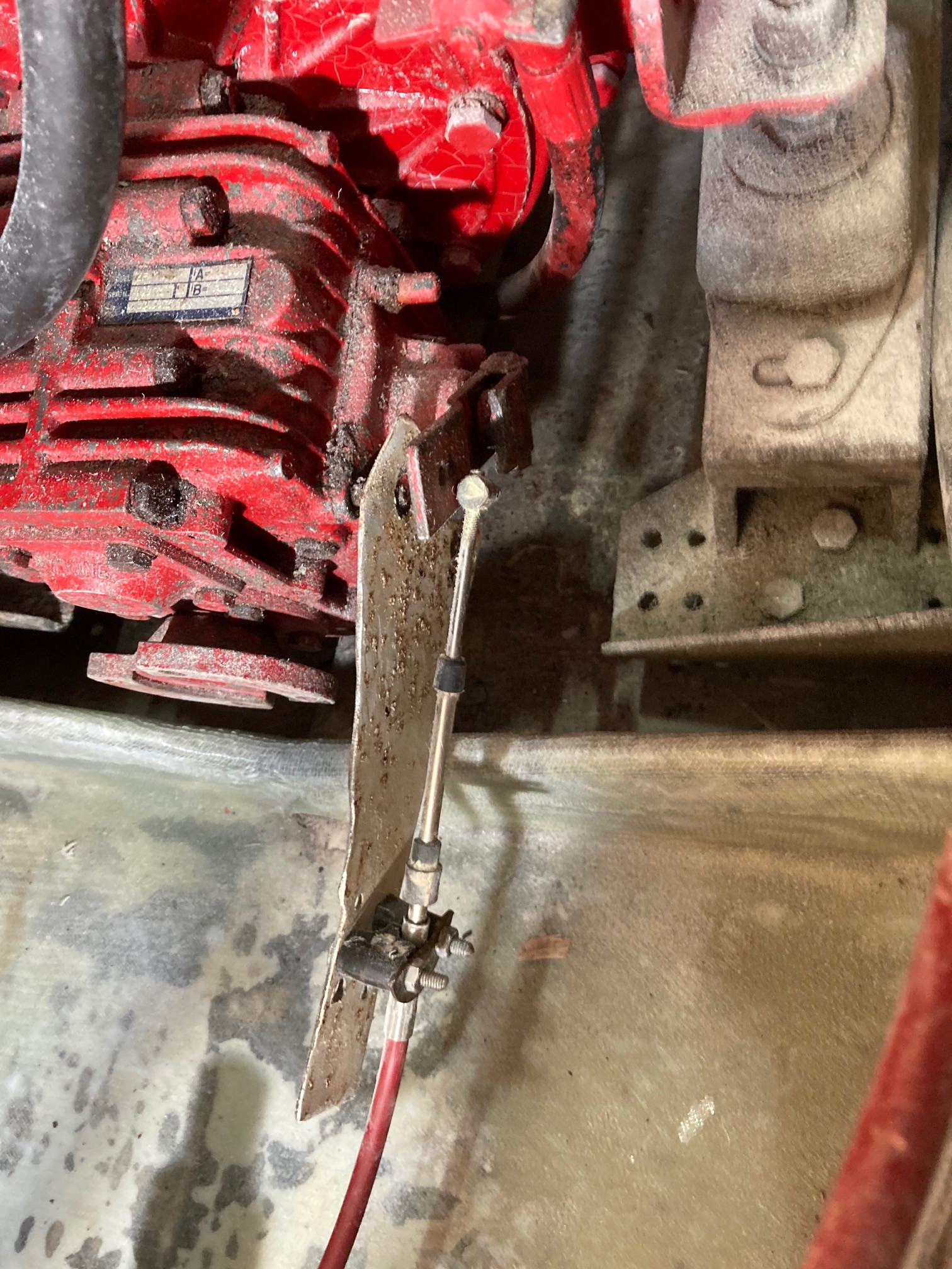

And here you can see the very basic bracket that the installers look to have fabricated themselves to mount the gearbox cable (I've just offered it up here). I'm not sure what was there before (or why it couldn't be re-used). I think the Beta gearboxes all have the selector on the opposite side anyway.
