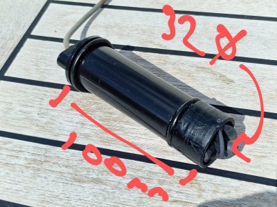

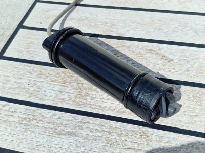

Bit of a long shot this, but does anyone know if there is a log transducer that will drop in place of an old Echpilot one? This one has died, and I replacing the whole fitting is not really an option, so if I can find a replacement transducer that would be perfect.
It's 100mm long and 32mm in diameter and has 3 wires (signal, signal ground, and 5v).

I should have been clearer in the measurements, it's 100mm from the bottom of the head - does that fit yours?

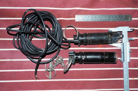

Mine is as below, 32mm on O rings, 100mm from top stop to outer hull. It is an Airmar, wiring is green, red, brown and white. It was working up to 2 years ago when the Navman head unit failed. The white is residual antifouling. There is also a blanking plug.
