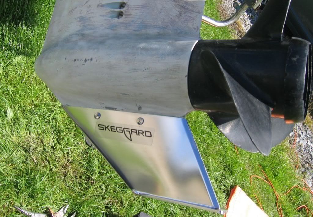

In the US things like a "Skegard" are available; a shiny stainless skeg that is designed to slip over the damaged skeg, or what is left of it. They are bolted in place. The problem I can imagine is that they are tougher than the aluminium casting they are bolted to, so they could well cause more serious damage when hit by something.
