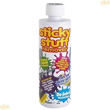

+ 1 for "Sticky Stuff Remover"
So what is the active indredient(s) of 'StickyStuff remover'? I'm sure you will have researched it, or at least be able to make a very educated guess.
IMO for the hastle and mess/damage that can be caused by scraping and experimenting with anything to hand it is surely worth 'investing' in a can of this stuff. It goes a long way and can be bought in gel or liquid form. Handy round the house?
It states: Extremely flammable. Contains amongst other ingredients: ALIPHATIC HYDROCARBONS>30% if you have any of that laying around?
Or: discuss.

That 'Sticky Stuff Remover' is complete rubbish. Might be ok on kids stickers but no good on industrial adhesives. The Evo-stik remover is ok or acetone/petrol mix.
