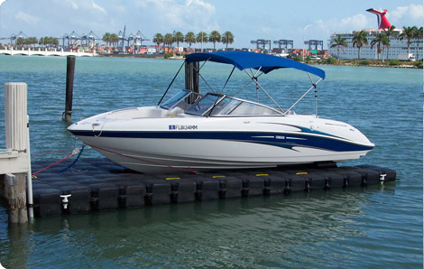

Wouldn't this sort of thing be better, but with a slot for the keel?
For a moment I thought the speedboat just had an alcoholic skipper. But that does look like a good idea...at least, in marinas...I'm not sure if several hundred polythene platforms would look pretty enough, to be approved by our natural-harbour conservancy bodies. :rolleyes:
There was of those bonkers "Buy a House Somewhere You've Never Been Before" sort of programmes on 't' telly a couple of months ago in Florida and the place was built around a canal system. Every house had boats on floating docks like that. See Here
The amount of sailing that some boats do would probably result in a sulphuric soup of dead organisms that disolved the gell coat.
Sounds a bit like Hythe "Marina Village", or the northern side of Port Solent.
There used to be a RIB on a piece of Versadock like that at Kemp's, though it's moved away now.
