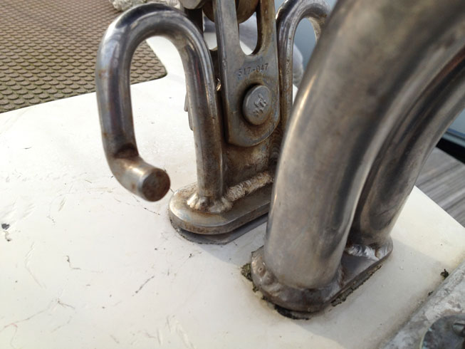

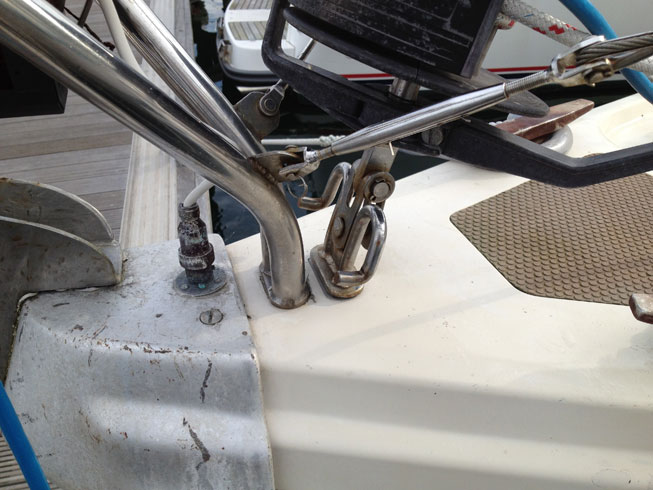

I have a problem with my forestay chainplate - as you can see from the images it's trying to come away from the deck.
My thinking is that I should replace it with something attached to the hull. The boat is moored at Brixham marina and I could do with some advice on what to do. I guess I'll need something fabricated and then fitted. So who do I call and how much are they likely to charge me!?!
What is the tang attached to inside the boat? The angle of the tang and forestry look linear..has anything changed of the mast forestry attachement etc...this might help guide what you do next.
My initial thoughts are to really look at how the forestry chain plate is attached to the boat, I wonder if it has broken away inside ( I have a similar style rotting which is attached to a bar internally that is in turn bolted to a fillet in the bow, if this attachement was to fail then I would see similar to your picture, q change of angle could cause this due the the load now being non- linear...photos of the underside of the chain plate would be very helpful

The boat is a 32' Dehler Optima98s and I think the current arrangement is the standard way for the chain plate to be attached on these models.

The deck is pretty solid where the chain plate is fitted - but I don't think the initial design has stood the test of time. And I think the designer might have economised a bit.

Access to the chain plate seems fairly good via the anchor locker, but I'm no expert and I don't know how much room is needed!

Enough room to do the job, you need to be able to see and get at least one arm to it while lying on deck.

There's room for that.
It was my surveyors idea that the chain plate should be attached to the bow stem and as he seems fairly well thought of in his trade I've respected his prognosis. However, I'm quite open to suggestion when it comes to a solution for this.
I take it the boat wouldn't need to come out of the water to have this work done on it?

I wondered myself about something similar to your second solution.
Mine revolved around some dirty great plate that reinforced the deck from below with the studs bolted through it.
