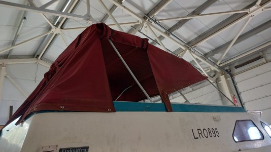

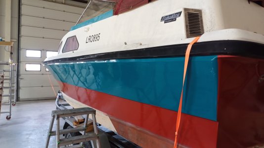

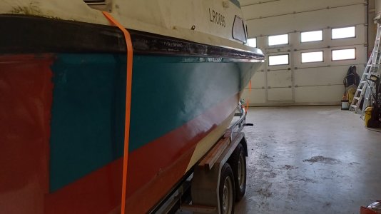

Hardly recognise the old girl !! Topsides though - white paint is worn through and not polished ...
Normally - I wash / polish myself - but with boat in the yard for them to remodel the canopy - decided to let them do it ...

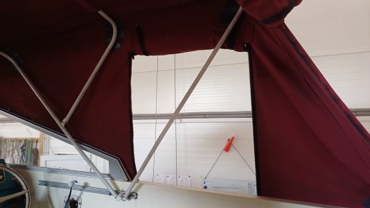

Canopy originally only had zipped opening at rear ... with no tie-backs. Decided to add side openings and all (sides and rear) have tie-backs to hold open .. really makes a big difference ...
I was surprised when yard recc'd keeping the old canopy and repairs ... they've added doubling pads where frame corners wore through ... added also at lower corners etc ...
Only thing is the extra few mm added by backing pads had made canopy very tight to rig ... so will need to adjust the frame mount points on the cockpit runners ...
