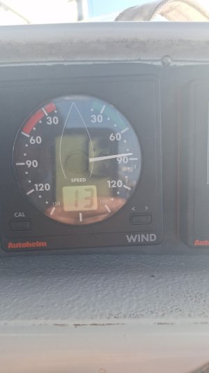

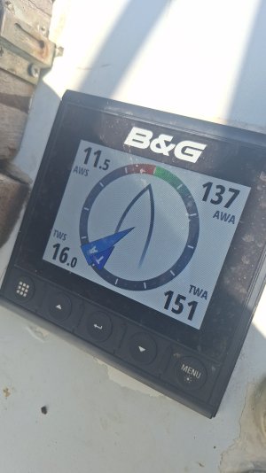

The windvane is showing according but not the information in the bus.
This pictures were took at same moment.
This was working good af few days before.
But when it was checking the calibration parameters in the ST50, at one moment the windvane suddenly moved to the "opposite side", like if it's switch from 30° starboard to 30° port.
But there is not calibration to change that.
The only parameters, in the equipment are:

So I'm not able to go the previous setting. I've tried disconnecting the multiplexer (that joins NMEA2k to SeaTalk), but as mentioned, in the SeaTalk Repeater keeps showing incorrect angle.
