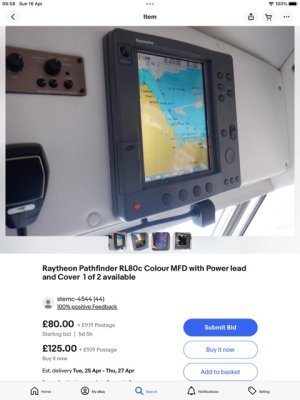

Ah yes £80 was the starting price and postage added This guy has 2
Still not bad though at a “buy it now” for £125
A1B47DAB-4D3D-423C-9630-6A76F407BC8F.jpegpostage added
