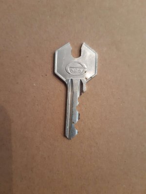

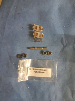

The bearings are id 4, od 8 and thickness 3mm. I made a tool from an old key ( in a vice) to get the bearings off the shaft. Please be very careful when removing the plastic disc for windspeed!

Many thanks these have been a great help and hopefully means that I don't need to fork out £480 for a new o!
