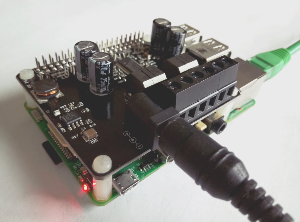

What works just fantastic is one of these -
https://www.hifiberry.com/products/ampplus/
A quality hifi amp which plugs on top of the Pi, provides power as well so just plug in 12v from batteries and a coupe of speakers and off you go. Then Clementine is an excellent music player. https://www.clementine-player.org/
Put all you music/video on a sd stick and play from anywhere, there's an android remote plus easy to control the Pi headless with VNC. Clentine is also very good for web radio and podcasts, syncs with gpodder so all you favorite podcast are kept in sync. For web radio I use clementine plus chromium web browser for any not in there like radio 4, though stutters a bit with youtube but OK if you minimize the browser.
