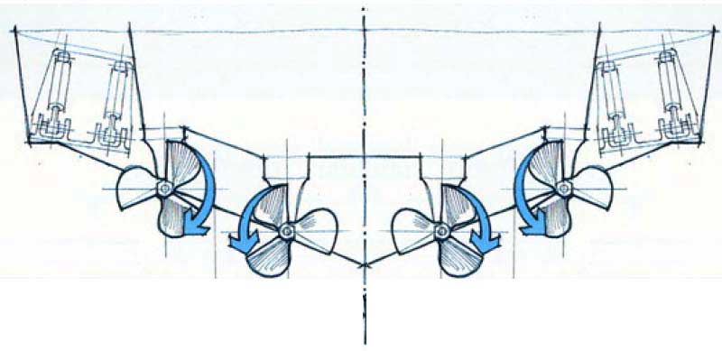

On a 4 engines monohull with surface props, would you go for the port or stbd props rotation? And why?
Or can you think of an even better alternative?

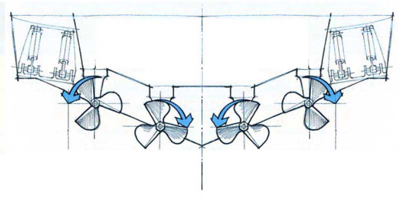

no reason (other than visuals and symmetry!), but I'd go for option A below, or if I have time to think about it, would go for option B.
OptionA:
OptionB:
I,d go for option B in the 2nd post .it would give 2x rooster tails in the air ( look pretty) but more importantly 2x thrust /jets of propulsion in the water pushing the boat in more harmony .
In other words better packaging of the water flow = more speed efficiency I think ?
doh!
just reread your Q MM, so my sketch of OptionA is what you call port and OptionB is strbrd...
sorry for the confusion, I initially thought that someone would setup in the same hull the mixed setup :rolleyes:
following tico's train of thought, I'd probably opt for OptionB or strbrd.

Option B.
Outside props blades travelling down on the outside into the water there by throwing less water up and out of the thrust area.
prop blades travel in the same direction where they are closest to other props = less turbulance perhaps? Just looks right and what looks right usually is right.
LOL, so much for the experience Buzzi had to make to reach the same conclusion! :D
Indeed option B is better, and it's with that setup that the Cesa 1882 won pretty much everything there was to win in offshore powerboat racing.
But I won't spill the beans on the reason yet, also because it has absolutely nothing to see with those mention so far...
Any other guesses? The virtual cigar is still waiting for a winner! :D
Interesting question, I think I would go for A as when the boat is on the plane the outer props could be cavitating and option A would mean they are working in cleaner water, also I would expect the stern to get better lift with this setup for the same reason.
But then not a problem I have had to consider, so just a gut feeling.

so outsides turn externally and inside internally, therefore props contact points with water surface occur on the outside so increasing stabilising forces as for some crazy reason Buzzi didn't like the boats tendency to have a rocking motion at speed ?
Your comment re. stern lift is indeed interesting.
Yes, you typically get more stern lift with props spinning outward, in "normal" boats with twin engines.
Since with option A the internal props, which are lower in the water, are spinning outward, maybe the effect is the same, at least to some extent.
Buzzi didn't comment on that on the article I read, so I would think that if the effect was there, it was not so relevant for his 4 props boat anyway.
Otoh, cavitation is actually an advantage, with surface propellers.
In fact, it's funny you mentioned it, because FB in the same article explains also how he invented a sort of "secret weapon" for faster acceleration, which gave him a big edge over the competitors for a few years, before also other builders understood and copied his trick.
Below is his drawing of a central trim tab which integrated a couple of air hoses, meant to bring air to the lower props.
This allowed them to cavitate well before the boat was planing, which in turn meant that the engines could immediately reach a higher rpm, hence developing more power and accelerating the boat faster. Amazing, 'innit? :)
Give that man a cigar!
Do tell, did you also read the FB article (which btw is also part of a book he wrote), or did you think about it just looking at the drawing?
I mean, it's not rocket science of course, but it took a while also to FB himself to reach that conclusion, in spite of the fact that it might seem obvious, when you think about it.
He was experiencing sudden snatching rolls at high speed, with that deep-V monohull, and when the boat began to jump from one chine to another, he could only reduce the throttles and/or lower the flaps to stop that. Not what you want on a racing boat.
He tried all sort of things, from a big wing above the cockpit to additional flaps mid-hull, which actually made things worse.
And then he thought to switch the rotation, which made the external props effectively work as stabilizers.
