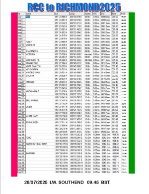

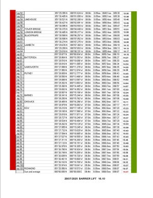

OGs at your own risk guide to arriving at Richmond with water dripping off the gates and with water under the keel.
Bearing in mind that heady SOG. of 10 knots in Sea Reach and the speeds beyond is with 2-3 knots of useful Thames flood.
Once through the Pool just keep an eye out (depending on the season) for swimmers and the more excitable sorts of rowers. :)
Kayakers appear to not much care at all.
This particular plan is obviously from Rochester, pick up from Mid Swatch though to Richmond.
