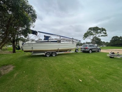

We have just arrived back from an exploration cruise of the Gippsland Lakes in Victoria Australia for 4 weeks and despite motoring half the time used about $140 of fuel on the yacht and $470 in the car to drag our yacht there and back a combined several thousand kilometres.
Fuel costs and the boats as mentioned above are not for relatively modest income retirees!😂IMG_6551.jpeg
PS with a115hp outboard we almost count as a motor boat. 🙂
